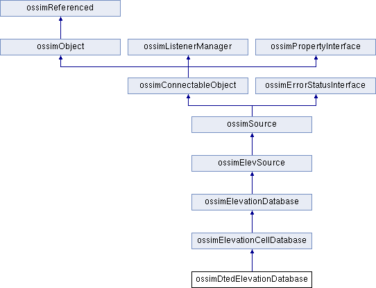

The DTED elevation data base is also an elevation source but allows one to point to an file based elevation tree.
The general format of a DTED elevation tree:
<root dir>="">/e|w<longitude value>="">/n|s<latitiude value>="">.<extension> Exmaple 1 kilometer: <root dir>="">/w023/n15.dt0
Note for 1 kilimeter the extension is dt0 and for 90 meter post spacing it is .dt1 and for 30 meter spacing it is .dt2
Definition at line 22 of file ossimDtedElevationDatabase.h.
