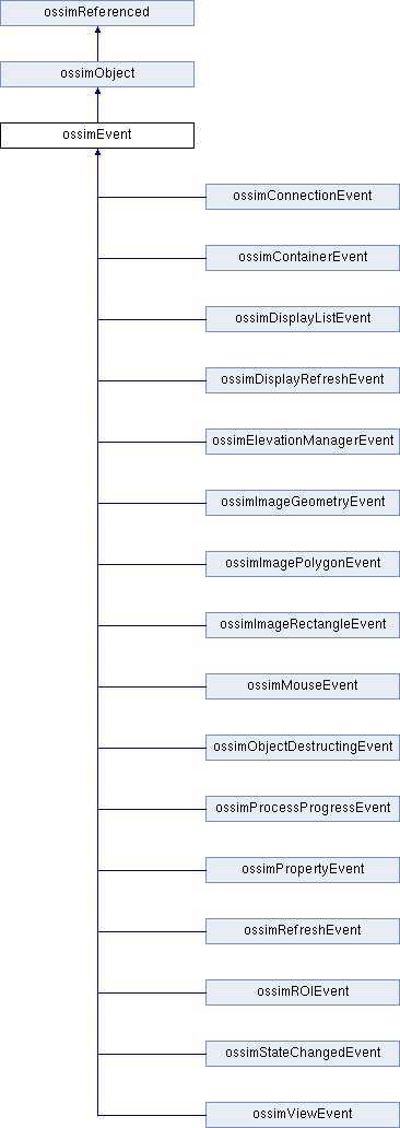

#include <ossimEvent.h>
Public Types | |
| enum | PropagationType { PROPAGATION_NONE = 0, PROPAGATION_INPUT = 1, PROPAGATION_OUTPUT = 2 } |
| ossimEvent (ossimObject *object=NULL, long id=OSSIM_EVENT_NULL_ID) | |
| ossimEvent (const ossimEvent &rhs) | |
| long | getId () const |
| void | setId (long id) |
| bool | isConsumed () const |
| void | setConsumedFlag (bool flag=true) |
| void | consume () |
| const ossimObject * | getObject () const |
| This is the originating object that originally produced the event. More... | |
| ossimObject * | getObject () |
| const ossimObject * | getCurrentObject () const |
| ossimObject * | getCurrentObject () |
| void | setObject (ossimObject *object) |
| void | setCurrentObject (ossimObject *object) |
| void | setPropagationType (PropagationType type) |
| bool | isPropagatingToOutputs () const |
| bool | isPropagatingToInputs () const |
Protected Attributes | |
| ossimObject * | theObject |
| ossimObject * | theCurrentObject |
| long | theId |
| bool | theIsConsumedFlag |
| PropagationType | thePropagationType |
Definition at line 16 of file ossimEvent.h.
